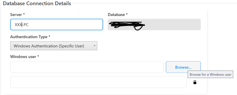

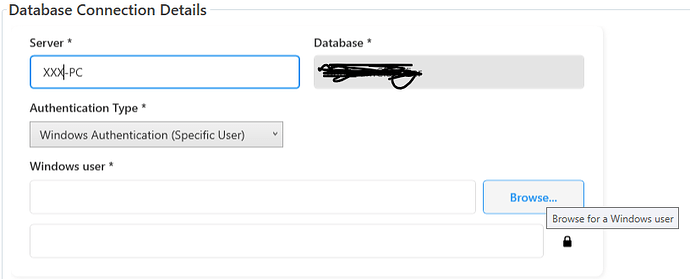

My understanding is that the background is logged on as ‘NT AUTHORITY\NETWORK SERVICE’ so the workaround i used was to ask user to enter credentials of specific windows user as i hope the screenshots can convey:

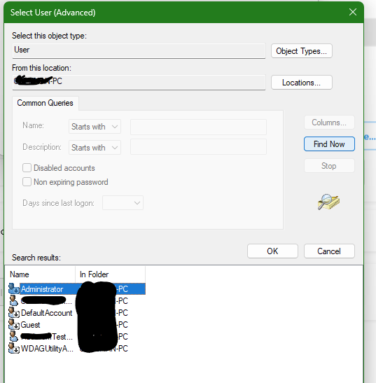

on browse for user click:

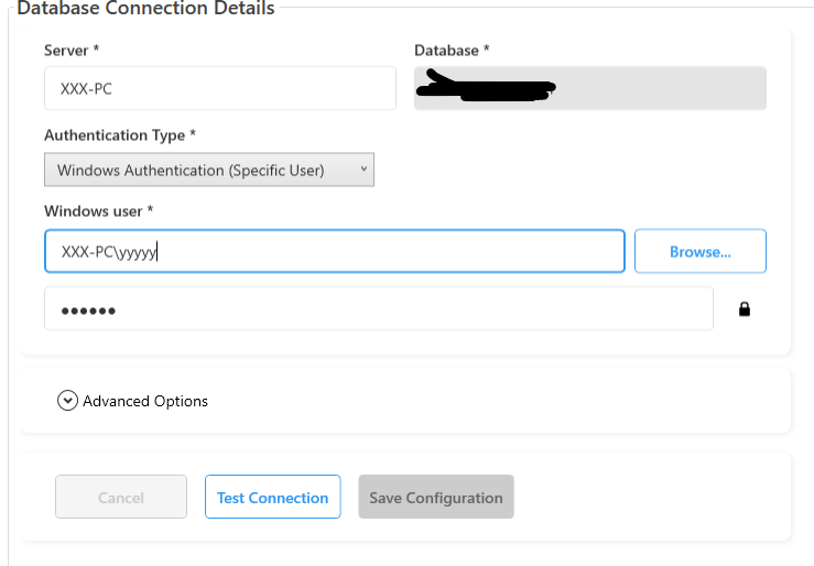

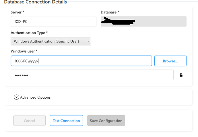

On selecting a specific user you enter the password of that user:
After all this we can impersonate the user from the user credentials so that we are able to use Windows Authentication
