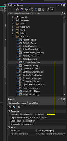

I you are using VS you have to set image as resource …
Freddy
Hi Freddy,
Thanks for your reply. That did the trick. Also drag&dropping the image directly into the XML will get the right path.
