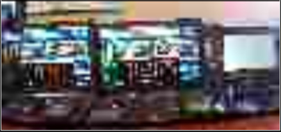

Hi, we’re having a weird issue here on Essential+ 2019 R3. When looking at the samples found in XPMobileSDK/Samples/video/videoSample.html, there’s an issue where the camera stream start displaying, but after 10 - 30 seconds, the viewer gets in a weird state where the canvas is all blury (see image).
Then, the viewer will alternate between a clear image and a blurry one every 2 seconds or so and it seems stuck in that state.

When breaking in the following the code when the canvas get into this weird state, I notice the following: the image naturalWidth and naturalHeight being sent is way smaller than what’s requested, and the resampling is upped to 4 instead of being 1 like when it’s clean.
if (frame.hasSizeInformation) {
var multiplier = (frame.sizeInfo.destinationSize.resampling * XPMobileSDK.getResamplingFactor()) || 1;
image.width = multiplier * frame.sizeInfo.destinationSize.width;
image.height = multiplier * frame.sizeInfo.destinationSize.height;

We will try to look into it, but meanwhile you could turn off web sockets, this effectively going from push to pull and this will disable the mobile server QoS.

Hey Petar, thanks for the answer. We’re on Essential+ 2019 R3. It does happen whether 1 or 3 cameras are running. They are sending about 10mb/s each from the Mobile Server. Using XPMobileSDK.toggleWebSocket(false); does seem to remove this issue, however, I notice less FPS and had better result just disabling QoS on the Mobile Server and staying on Push. I think I’ll just leave it that way for the moment. At least I understand why it’s different on the Web Client now. Thanks a lot!
