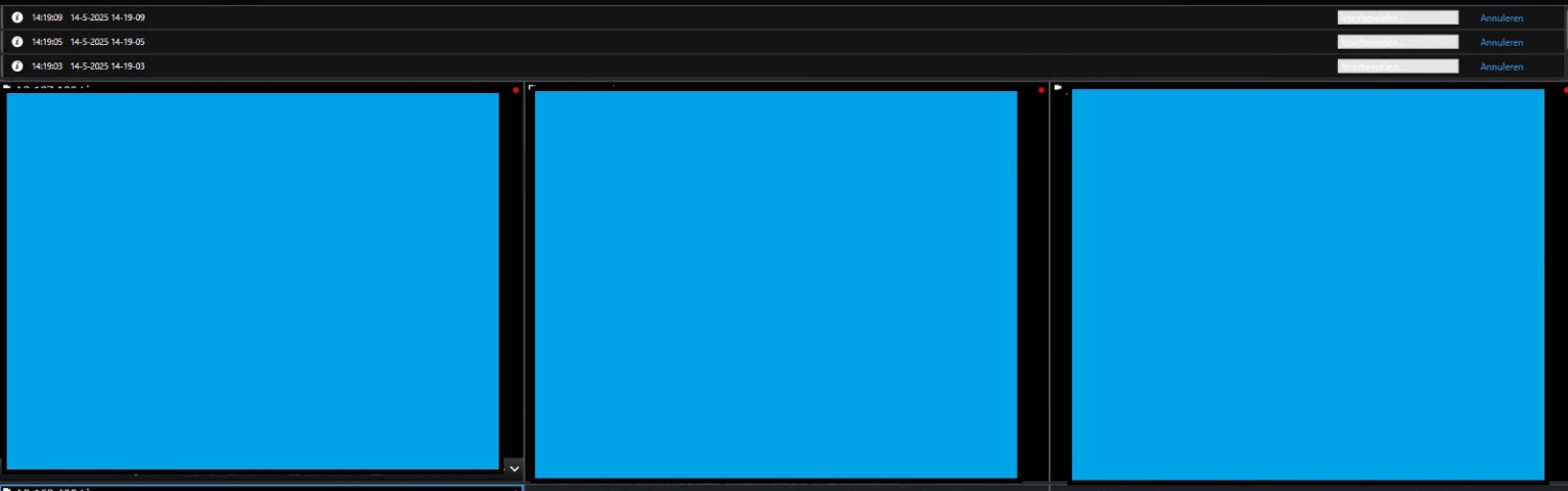

The MKV exports properly, and fast. And the SDK integration triggers a export bar on screen in the Xprotect client. In testing all went well, but in production, most of the time the export bar does not update, and gets stuck.
Ideally we don’t show the export bar, but i doubt i can disable it, or auto close it. ( users export often, and the 3 bars take up screen space and cause extra workload to remove )
But when testing now it gets stuck and also its a pita to remove, ( because you need to cancel and it cant cancel, because there is no active export)

Screenshot in dutch, all these exports are done and available on the local drive.

100% sure when it happens. If its a single view its fine. If its a multiview with more than 3 or sometimes 4 its not. As soon as you switch to single view it updates.
