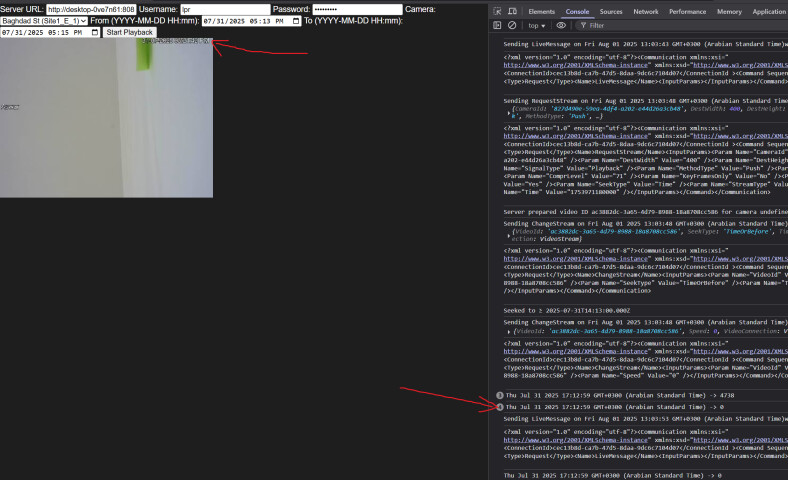

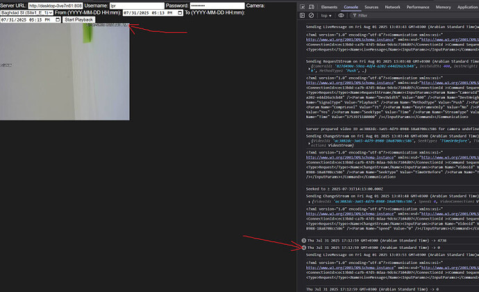

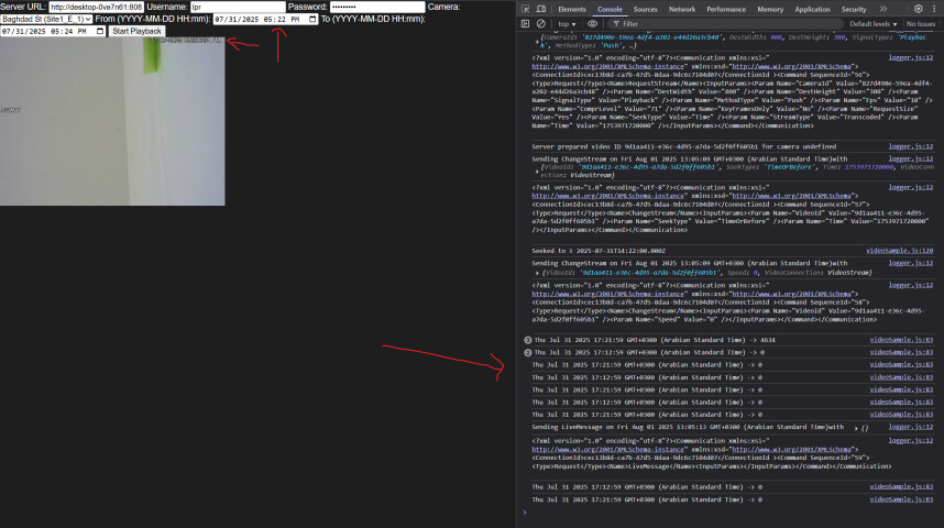

Hi, we have problem in fetching playback videos from mobile server.
The problem is whenever i try to get playback i only get the first frame, the others will be with dataSize 0 and wrong date time (the first frame time only). here is our code:

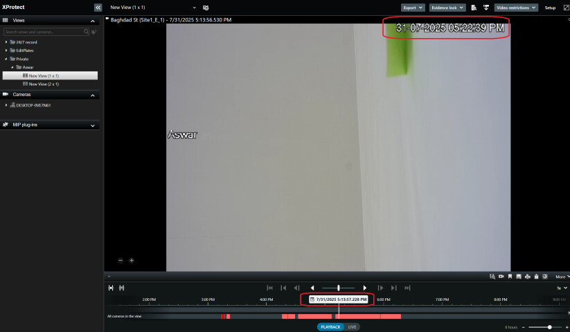

I checked the time and records in smart client and everything is fine.
We also have two posts about this issue and we didn’t receive any solution for the problem.
Post 1 , Post 2
also you can take a look here at the example and smart client playback to see the issue:
