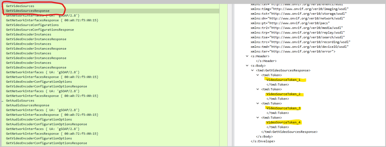

//picture from the beginning of the Wireshark trace, when you mentioned a successful attempt to add the camera to XProtect.
First, let’s mention that GetServicesResponse has the same content at all different times when it was called, which means we have received the right information.

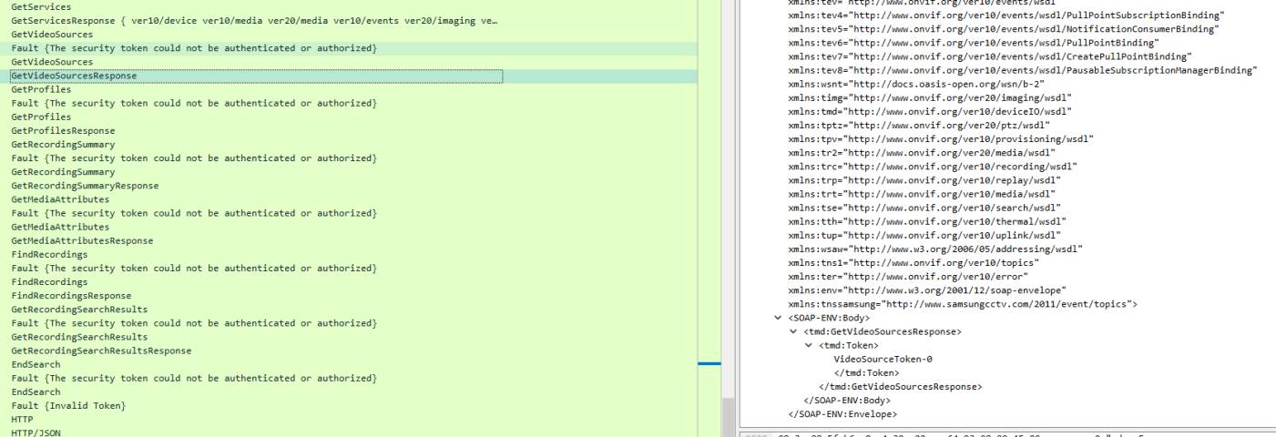

Let’s scroll down to the end of the Wireshark trace, where the possible recording attempt has happened.
And the problem comes with the next additional responses regarding GetVideoSourcesResponse.
From the picture above, you can see how looks like a typical response to a GetVideoSource request.
// GetVideoSourcesResponse at the end of the trace.
You can see that we have missed the video source token information, which prevents us from continuing the recording requests.

Here, you see that we have tried 2 times to receive proper information about the GetVideoSources response, but were unsuccessful. That is why we cannot proceed with retrieving the data.
// For example successful retrieval of data from another camera
We have all needed requests like GetVideoSourcesResponse, GetProfilesResponse, GetRecordingSummaryResponse, etc.
//From the same picture, the response of GetVideoSources. The video token is added in the <SOAP-ENV: Body>
So, based on the provided wireshark trace and the questions that you came up with, we could conclude that missing information in the GetVideoSourceResponse caused the problem, and more closely, it is because of not having the information about the video-source-token.

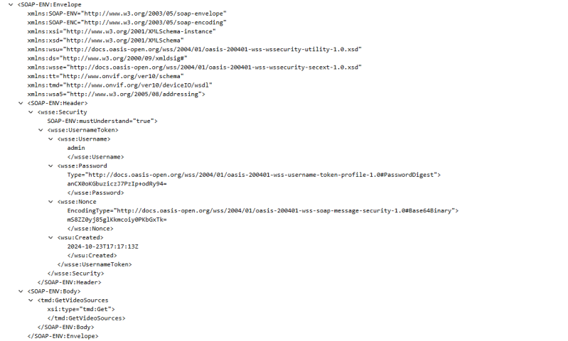

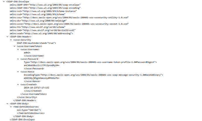

I think the fundamental problem is that when adding the device, Milestone is prepared to use WS-UsernameToken auhentication. Here is an example of Milestone doing it for the GetVideoSources request:
Milestone is passing the UsernameToken in the header part of the SOAP message to allow the message to be authenticated.

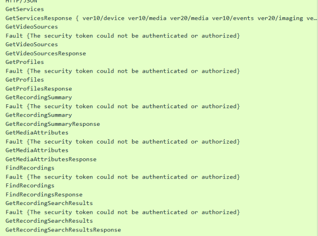

However, when the same request is sent later for the video retrieve, a UsernameToken is not sent:
There is no header provided in this message and therefore no UsernameToken for authentication. This is hence rejected by the device.
The device returns the NotAuthorized fault code:
Milestone never tries again with a UsernameToken.
