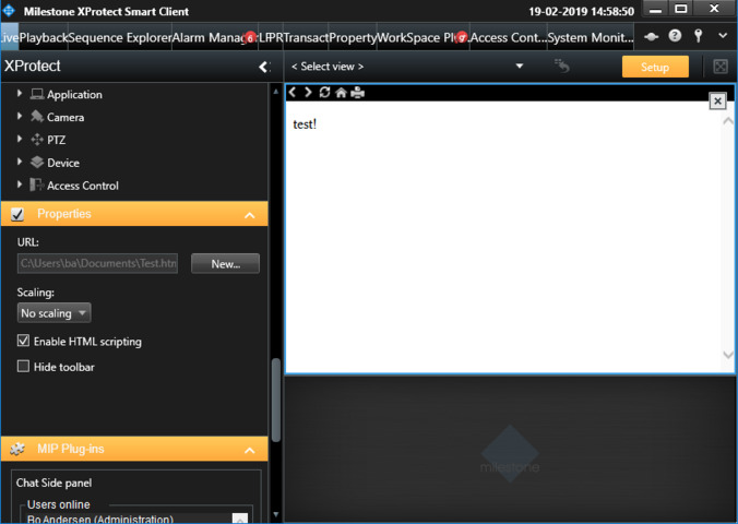

Is HTML Scripting enabled?
Yes Html scripting is enabled. We enable that through the plugin code
prop.Add("Addscript", "true");
And add the property to the View
_currentView.InsertBuiltinViewItem(5, ViewAndLayoutItem.HTMLBuiltinId, prop);
I wonder if not your plugin works perfectly, but something has changed on how the HTML page works. If you test using the HTML page by using it in the Smart Client without having the plugin involved, what do you observe? Does the HTML page work within the Smart Client when manually added but fail if added by your plugin?
