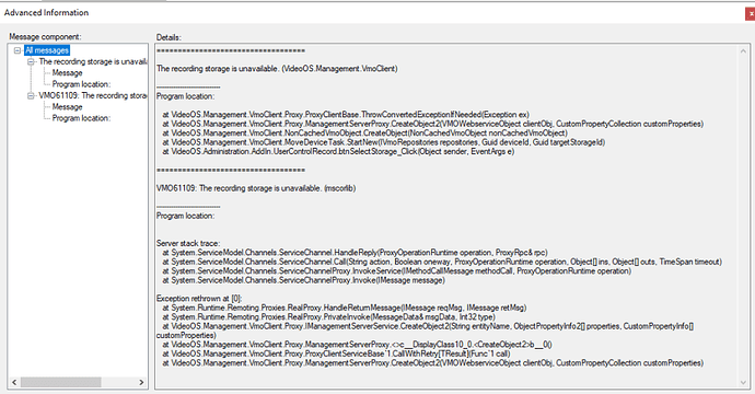

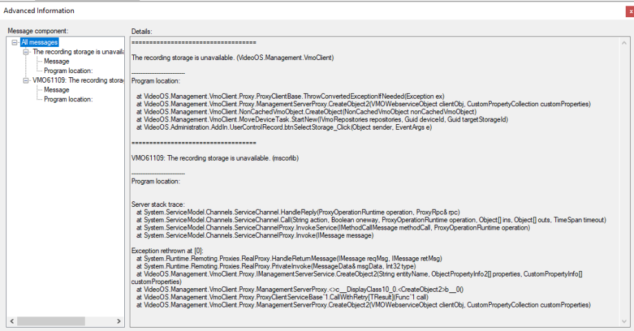

Hi! We have a XProtect 2024 R2 installed that we use as a testserver when developing an integration. It has worked fine for about a year but now our Recording storage has been marked as unavailable and no new recordings are made (and no previous recordings are available), We have tested to create a new storage (pointing out a new folder with the same permissions as the old one). We can create it but when we try to change an camera to use the new storage we get an error:
We have looked in the logs and the only thing we have seen that feels related to the problem is this in the MediaDb log:
