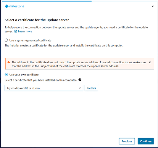

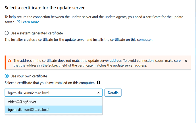

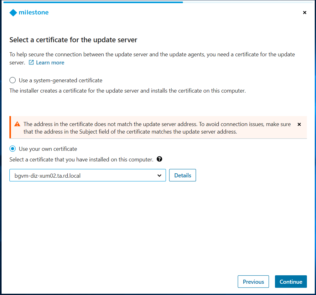

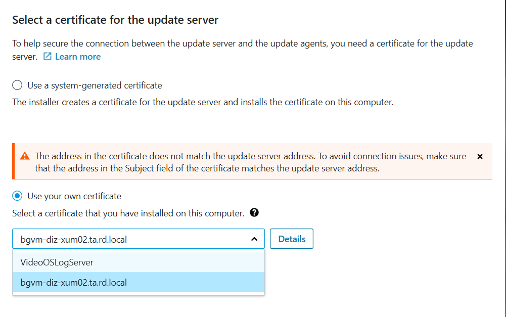

An expert in Milestone Development answers as follow:
It is normal for the Agent to default to a self-signed certificate during a “standard” click-through installation, but you can definitely change this to match your internal PKI.
Milestone fully supports using your own CA-issued certificates for the XUM Agent to keep your environment consistent. You can configure this through the installation wizard (GUI) without needing to resort to the command line:
  1. Preparation: Ensure your internal CA certificate is already imported into the Trusted Root Certification Authorities store on the Agent’s host machine.
  2. Installation: When running the XUM Installation Wizard, look for the Select a certificate for the update server step.
  3. Selection: Instead of selecting the default “Use system-generated certificate” option, choose the option to use your own certificate. You should then be able to browse or select the specific certificate issued by your CA.
Why the difference?
The Agent defaults to self-signed to ensure encryption is active “out of the box” for users without a PKI. However, Milestone built the Update Manager to be flexible for enterprise environments like yours where central trust is a priority.
If the Server and Agent are already installed with a self-signed cert, the cleanest way to switch is to run the installer again to point it to your PKI-issued certificate.
Hope this clears things up and helps you reach that 100% PKI-consistent setup!
Here are some screenshots how it looks like where you can choose between self-signed and CA:
