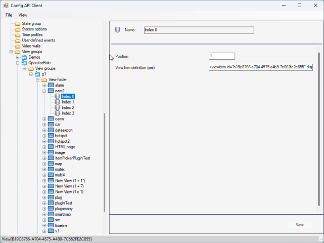

You can read the views using the Configuration API (Rest API, Configuration SOAP API, and MIP VideoOS.Platform.ConfigurationItems classes).
To see this in action you can run the Config API Client sample and expand the ViewGroups node.
(Camera can be read from “viewitemxml”…
