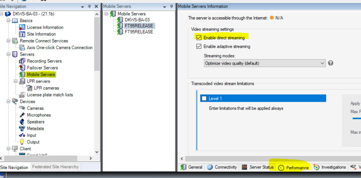

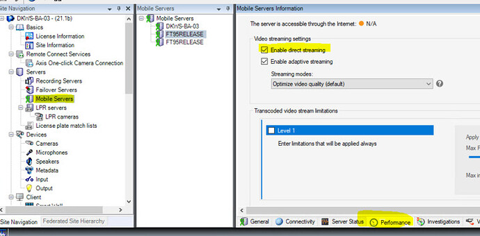

Please configure direct streaming on Management Client.
Start Management Client – Servers – Mobile Servers – select a mobile server – Performance tab – check on Enable direct streaming (see below).

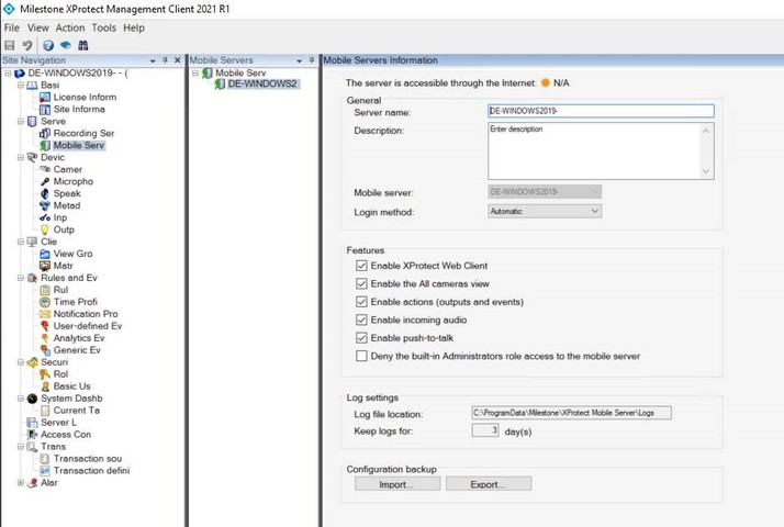

We cannot see video streaming settings on our environment. Is it because we have Milestone Essentials license?
Yes. Direct streaming requires XProtect Expert or XProtect Corporate.
