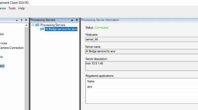

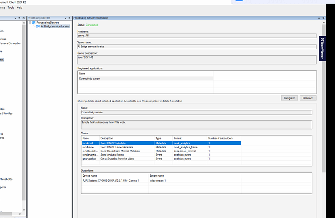

I’m currently working on integrating AI Bridge with a Milestone VMS (XProtect Corporate 2024 R2). A couple of months ago, everything was running smoothly—I could use GraphQL mutations to register the analytics application, and the AI Bridge showed as healthy and connected.
I am subsribing to the topic, as and it shows in processing server subscriber list as expected.

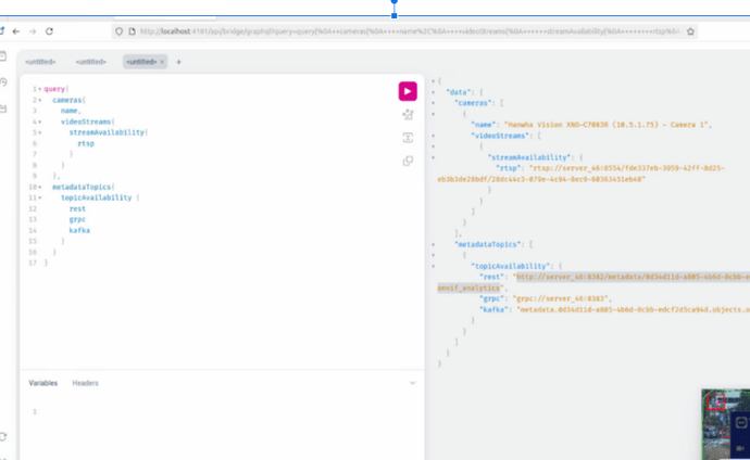

rest_url": "http://server_46:8382/metadata/0d34d11d-a805-4b6d-8cbb-edcf2d5ca94d/objects/onvif_analytics
Hi @Lisber Pontes
This is the rest end point that is being read from graphql api.
You are asking me to change it to
http://server_46:8382/**processing-server/**metadata/0d34d11d-a805-4b6d-8cbb-edcf2d5ca94d/objects/onvif_analytics.
But the older one is also giving 200 as status in anycase, I will do new change and comeback later.

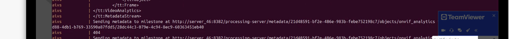

Hi @Lisber Pontes​ ,
I changed url to add processing-server, but only to get 404 from rest endpoint.
is there anything else, i can do?

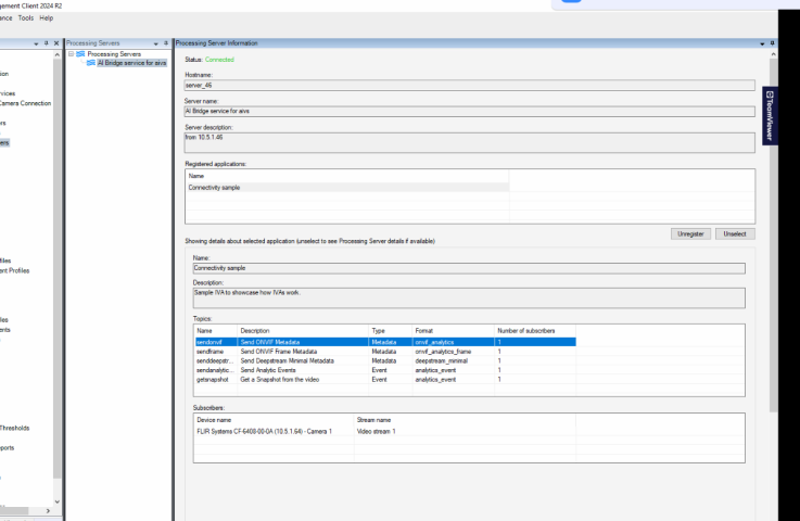

Added service, topics subscribed
But still doesnt see any metadata, or am I expected to see anything??

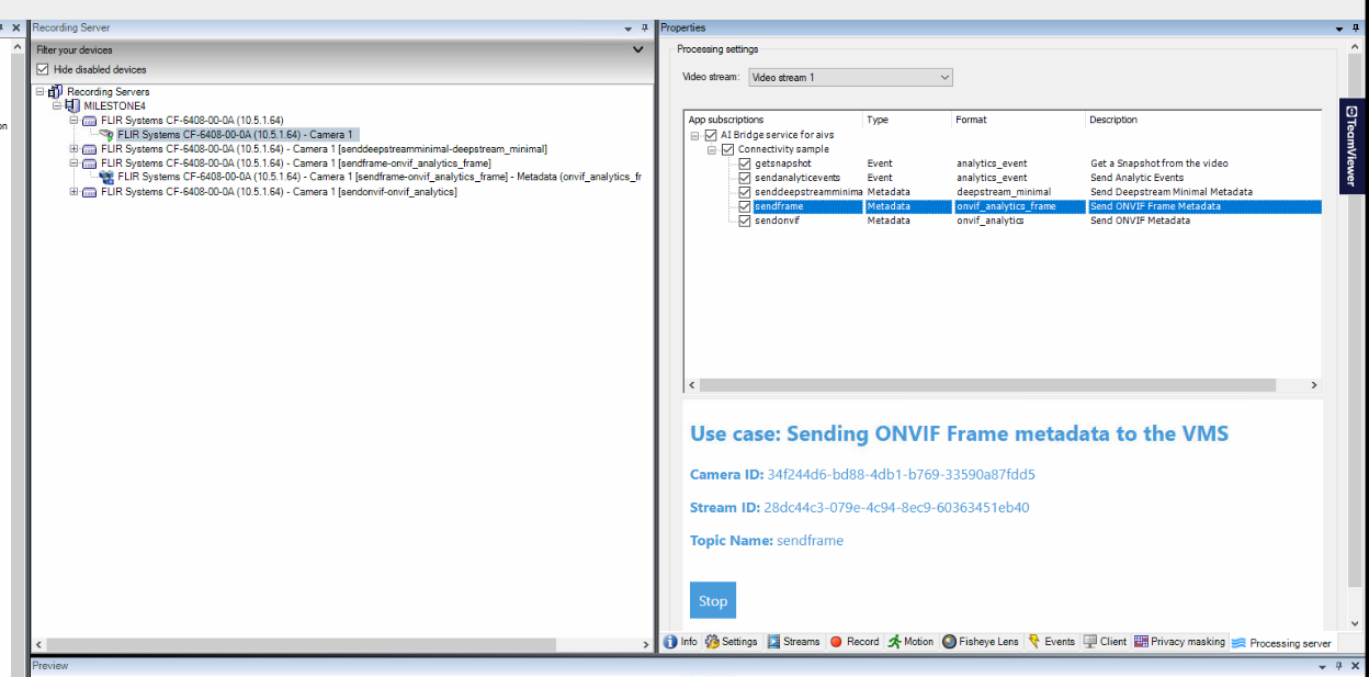

Using the connectivity sample app (mentioned before) there’s a topic that renders a live snapshot of the camera, it is called ‘getsnapshot’.
When you click on it on any camera, can you confirm you see the snapshot being rendered ?
I clicked on start button in processing server page, nothing is seen or capture is not done.

I was referring to the topic called “getsnapshot” (is the first one of this app).
Please click on it, and check if there’s a snapshot render in MC. If not, please attach the AI Bridge logs.
This topic will end up contacting the RS to get the snapshot/thumbnail of the camera.
Sorry, Will repeat and come in sometime
Hi @lisber
it worked!!
